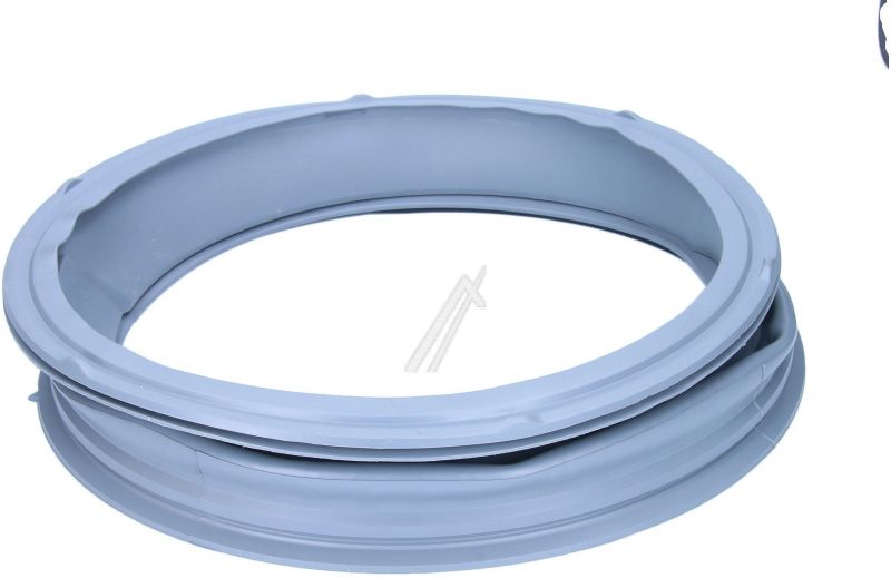

Türmanschette LG Electronics MDS65654402
56,59 €
